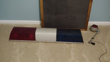

You are correct, Michael. The end caps are the first clue as the are at an angle inward from top to bottom. The solid center section means it was most likely a wrecker version of the DualComm (I have one that has clear domes and solid speaker cover--it came on the wrecker when new). BPD would have had mostly red to the rear on the driver's side.

How can is see what the voltage is of the light? could it be 24v since the rotators are 1/2 speed of all youtube videos i see?
What do you mean with ”1/2” speed and to what specific bar do you refer to?
The usual flash rate in the US at the time is about 80-100 fpm.
24Volt in the US is more or less only used by the US Armed Forces and a few fire vehicle manufakturers
All cars and commercial vehicles use 12Volt.

The bar in this movie seems to have about 90 fpm which is normal speed.
I do not find any movie of your amber light so I can not compare.
If you say that it has half the speed (45 fpm) something is wrong.
Where did you get that bar?
In Europe or in the US?
If it has been used in Europe it might be a 24Volt bar.
If there are no markings on the motors there is no way to know the Voltage.
Did it came without sealed beams?
Reactions: Thomas1234
By the way, I have looked at your pictures again and I can see that yours have a name tag on the speaker grill and to what I know it was only Yankee that had that.

These are 12v, can't find any markings on the motor, and the badge is faded..i cleaned the motor, and both rotate at the same slower speed, so i might think this is a 24v bar, with 12V Sealed beam. Thanks for all the info, appreciated!
The most obvious visual difference I can see between a Yankee / Dietz bar and a Signal Stat bar is the speaker grille.

Well I've seen the same type of lightbar on some other cruisers in my country, here is an example below, I was wondering if you also noticed a label or makers mark on any of the lightbar's sides?
