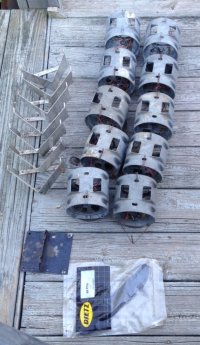

Nice!! The Dietz bar (identical the the Yankee--I think Dietz preceded Yankee) had options of two rotators per pod/side. Jefferson Co. PD (Louisville, KY pre Metro PD) ran this bar sans speaker cover with a Q2B mounted instead! IMG_0016.PNG
Outboard rotaters were 80fpm and inboards were 120fpm and the V-mirror was in between...talk about a light show! The domes ware sloped on both ends...don't know if that was special order or the original design, but Yankee domes were sloped only on the outboard side. JCPD ran the EMS service as well--PD hade all blue and EMS had red/blue so tapering both ends made them totally interchangeable. If you need a replacement rotator, I have several.
Alas and alack, the end cap and speaker mount went other eLB members some time ago.

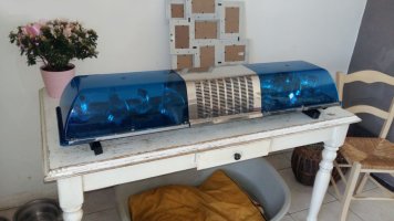

And its even working! Must say i really like those fancy rotators with the inner motor, clever design although with all those wires it can easily short out as i experienced- took my 1 hour to find the short, for now...Turn it on!

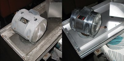

The good old & new comparison:
A lot of polish, wax, buffing and (wet) sanding, using exactly the same parts.
Wow that looks amazing! Great job! I might have to send you my bar for a good polish too. lol!

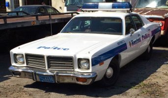

Used on a cop car in Boston.
I am not so sure that this car is a real Boston PD vehicle.
Someone with better knowledge of BPD cars might cut in.
I do only remember BPD using Code 3 bars at that time.
The bar look more like a Signal-Stat DualComm than a Yankee/Dietz 911.
This bar do not have any speaker holes to the front which make me believe it to be a prop vehicle to some TV show or movie mounted backwards.
Updated:
After a little search of the internet I found that this car was part of the filming of a TV-movie from 2015 called "Broad Squad".
