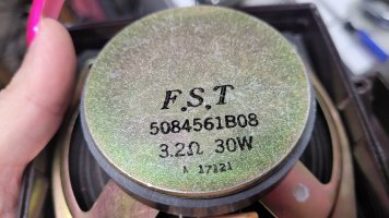

The first is to use a Motorola speaker with a Federal or Whelen siren on the display (so pretty quiet). The speaker is 3.2 ohm/30 watt. A volume adjuster would be nice to fine tune it but I wouldn't need to adjust after setting it. Without knowing the voltage put out by the siren I am not sure how to be sure I would have the correct resistors. Looking for a volume level equivalent to quiet television or office speakerphone.

Thank you. That should be fine then for a siren speaker, any idea about a smaller speaker? Says 4-100 ohm but the main speaker I want to use is a Motorola external 3.2 ohm for its size and portability. I figure only w couple of watts to the little speaker would be more then plenty. I'll try to reverse engineer the numbers for the Omega and see what else I can learn.
I keep telling you it will run a speaker as small/low watt as a 2-way radio speaker
