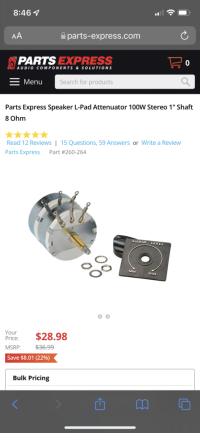

Although there have been great suggestions presented for reducing the volume of sirens, I believe this one is the most versatile. It's a 100 watt stereo 8 ohm Lpad wired to give a 200 watt 16 ohm mono Lpad. This gives you the ability to adjust the volume from very low to full volume with a twist of the knob. Because of being an Lpad the sirens sees a fixed impedance from low to high. I chose the 200 watt version because I have been using a 100 watt 16 ohm Lpad but with a 100 watt siren and the pad turned to very low volumes it heats up very hot. Applications include man caves, parades, car shows, Emergency Equipment sales demos, etc. The Lpad costs $25.00 so it is not as inexpensive as some of the other solutions. The Lpad part # is 260-264 and can be found at Parts Express: the #1 source for audio, video & speaker building components. Below are some pictures and a short demo video. Click on top picture for video.

The late Henry455 gave a link to the LPAD he describes. MtnMan links an easy to read description on actually wiring the LPAD.
Attached is a screenshot of the LPAD that Henry455 uses.
The 2 members talk about 2 LPADS.
Does the screenshot part incorporate those 2 LPADs? I seem to think it does but just want to confirm.

As a follow up.
I picked up the stereo, 100 watt 8ohm, “L Pad” described above and wired it to the diagram provided a few posts up.
I can say this works beautifully and very easily. Full adjustment.
I highly recommend going this route for quieting a siren for various reasons.
