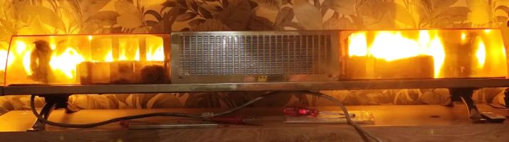

Hello folks,
Here's my new aquired Twinsonic Lightbar.
Oddly enough the end caps read "12x0", Series A3.
Its in quite rough shape and want it to restore it as good as possible and throw on red or...
Good progress so far, domes are sanded and polished, barrel filters are polished. I did some experimenting with the V-mirrors it had vs the diamond mirrors. The diamond mirrors throw off more...

Yes, the chains are intended to drag some. They were liberally lubricated by FedSig in white lithium grease that may be quite thick by now.
Your bar is, as we say, is quite a bit crusty (not...
