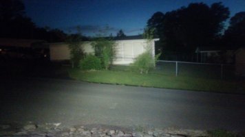

Looking at them from the neighbors house you see lit up
Close up to get all 4 lights in frame..

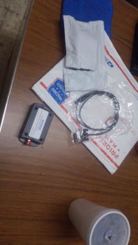

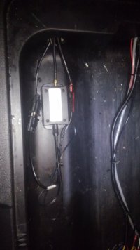

Finally got an APRS tracker... Byonics RTG it's a 10 watt transmitter and one of their tiny track 3s in a self contained box...
It takes a small GPS, uses it's signal turns it into a packet and send it's through the airwaves .. which is picked up and retransmitted by DigiPeter's and Igates...
So here's some install pics...
All of the pics loaded out of order..
here it is all installed and running. db9 connectors are the GPS. antenna and power/ ground...

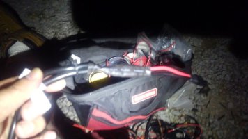

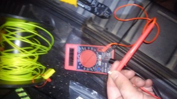

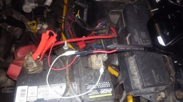

Attaching the anderson power pole connector to the ground side.. this wasnt attached yet just adding the connector to a roll of ground wire.

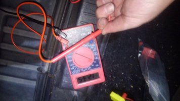

I didnt "label" the 2 wires i added to the console so i used a good ole HF meter to see which wire had power when the switch was on..

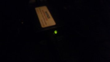

no flash to see the unit powers on and works...

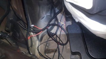

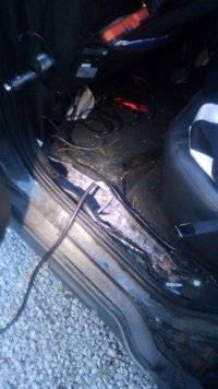

pulling the wires through the carpeting to the rear to the storgae box...
running the wires under the carpet tot he console..
HF meter again for the 2nd wire

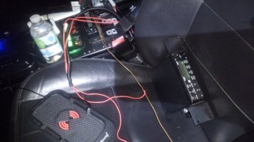

wires up in the console before attaching to the Carling console switches.

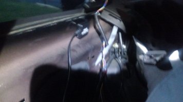

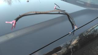

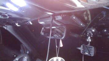

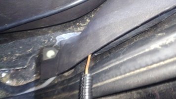

wires fed through to the rear... while i had this opened back up i put some loom on the side mounted fusion.. in this pic is 2 coax cables the GPS cable (db9 lead) wiring for the fusion and the 2 new power wires..
used the trailer wire negative for the negative post for the HF meter.. LOL

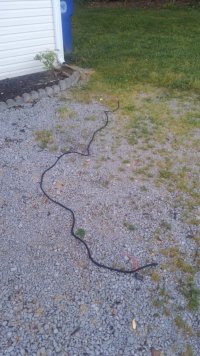

The snake under the carpet now..

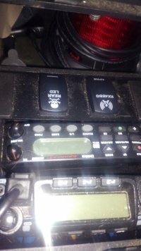

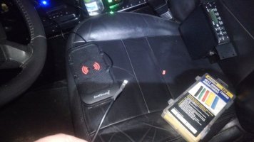

The GPS unit. it is supposed to go on the roof. but since it doesnt come in a NMO mount and i didnt want it up on the roof i checked with the maker and he said as long as there isnt too much metal between it and the outside world it should work here... its up on a "hump" near the back glass. i test ran it for a few days there and it never moved with its magnets so it should be good there...
had to drill a big hole for the db9 to pass through pre connection.. you can see the antenna coax here as well. i bought a small SMA to pl259 cable to run from the RTG to the antenna
connection of power wires before looming

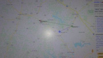

1st time it got picked up by a digipeter/ igate... on my way to work today my county is a deadspot for APRS but thats another project for another day that im only a few components away from.. the closest digi /igates are in Rutherford, Coffee, and Maury counties..
When i went to lunch in the town with the digi / igate

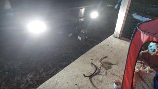

Another project done for now. Im not to crazy of this set up but its temporary. I still want to flush mount some leds in the bumber but this will work for now.

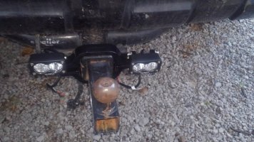

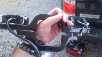

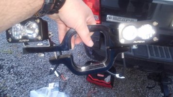

this is an IDMjoy mount that is readily available on many sites. I paid about $30 shipped for it it is "supposed" to fit on most receiver hitches.
i always upload these in order but they get flipped somehow.. this was testing it on the battery...KIMG1348.JPG
mounted and tested on switch power

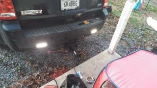

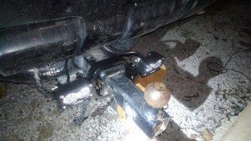

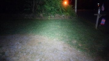

yes it was somewhat day light when i started, temps in the 90s so i waited a bit for it too cool off some. i had to mount the lights on top of the mount as the brackets dont fit on the bottom this bracket is meant for stud mount lights but i didnt want the big ol things hanging down from the bottom as they would bottom out every time i left the house....
i also had to disassemble one lens to make it when the spots where on the inside and floods on the outside... also had to flip it so the light was closer to the mount and not 2 inches taller as shown.. the lights are from wally world and were $22 a piece.

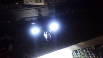

distance shot about 25 feet away
testing the wiring before shrinkwrapping everything.. used a couple of SAE plugs to make for quick disconnects. (as seen in photo above)
back of the mount to show height differences
test fit before wiring (note flood spot spot flood configuration)
the switch

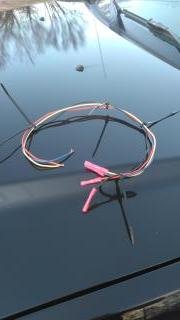

remeber the red wire with a cap from last update.. ohh look there it is....

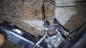

there isnt really a place to mount a ground on the hitch. since i had a ground here for the 4 pin relay, and the wiring from the cannon come through here.. i ran the power wire through the same hole as the ground as the cannon and grounded it in the same spot as the relay ground.
lights on i beleive this is when i put the 2 pin sae plug on the trailer connector to test wiring before i hooked up switch power.
light wiring butt spliced/ heat shrink individual wires and then added a bigger piece of heat shrink to cover both. also zip tied the 2 light wires for protection
i beleive this picture speaks for itself.. next slide please...
ran the wiring from the lights under the bumper between the hitch the SAE plug is about another 6 inches behind that i still need to loom tot he plug...
i guess i didnt add a pic of the other end of the wiring. but i have about 4 feet of wiring running from behind tail light to the other plug. in case i get bored with this or need to take it for some reason , i can just reach back unplug it and its off...

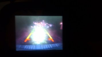

back up camera with new lights on
back up cam without new lights on..... i upgraded the backup lights with leds (https://www.superbrightleds.com/moreinfo/miniature-and-subminiature-bulbs/194-led-bulb-cob-led-t325-miniature-wedge-base-135-lumens/6325/14245/?utm_source=product_review_email&utm_medium=email&utm_campaign=product_review_email) as well but they arent as bright as id like so im still looking for better options...
most of the light you are seeing is from the LP lights i upgraded them to led 194s back when i first got the vehicle..

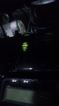

so i still have room for 2 more devices in that console plate.
1 will be a front led bar if i can find a pushbar with one already built in and the other IDk for now.. LOL

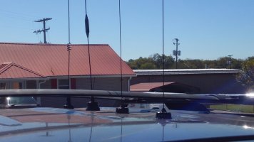

Antennas are now permanent and no longer 4 mag mounts...
The antennas after I took the mags off and rolled up the coax. With the NMOs still curled up.
I didn't want to take pics of the Installer without his permission so I didn't get in progress pics..
Yes they are closer together then I wanted but with little space comes little possibilities... We put the first antenna where the sun roof tracks stopped... And the last antenna just before the real dome light..
The 2 primary transmitter antennas are more than 1/4 wave apart so in theory they are safe...
The other 2 is the scanner and 220mhz and won't be affected by the other 2 so they are spaced 7 inches apart...

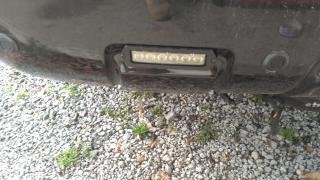

The update i was talking about in the last post is visible here as well.. Brighter Leds in the fog lights and Smoked lenses

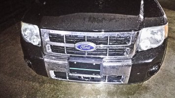

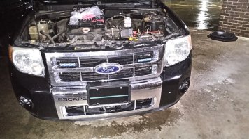

pulled a boulder, worked on an install at work. i didnt think it would take longer to remove the old ones then replace with new! 2 T3s and 2 fusions
Yes it was raining. a Bare Grill... ( not to be confused with a Bear Gryll)

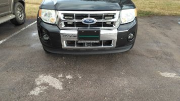

I was told some modification would have to be done to the fusions brackets to work on the Quads.. so... here you go. Used a Step bit to make it twice the size.
did i say it was raining that night? Quads in their new home.

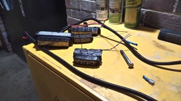

little premade harness for this project.. reusing my old grill lights for rear lighting...
havent determined if i want to hook the reds up to the rest of the warning yet. it will depend if they will sync with them or not. seeing how my luck is going it probably wont but another project for another day
went and had this done by a local shop. i took them the lights and had ordered some flush mount brackets. they charged way to much for labor but it is what it is..
Ive got them wired on the harness that was controlling the lights on the trailer hitch. those lights will be coming off. they kept coming loose and really wasnt impressed with the setup.
Yup they work... pre finished with this part of harness
