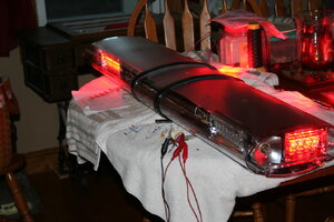

I just finished a "custom" MX7000 that will soon be mounted on my SAR team's one truck. I used the components of two bars (and a random OsciLaser that I had laying around) to make one amazing one. I'm thinking about upgrading it later once I get more parts (like high speed rotators), but for now it's the best I could do. Pretty much it has red outer lenses and a clear inner. There's a rotator on the outer spots and one in the middle with a red filter. The inner rotators were replaced with OsciLasers. The lower section has an alley and intersection sweeps on each end and starting from the left is a red flasher, a strobe jerry-rigged into a flasher housing hooked up to a Priority Green Pre-Emption power supply, two white flashers in the middle, a steady burn red, and another red flasher. The four flashers are hooked up so the left outer & right inner alternate with the right outer & left inner. As you can tell, there's nothing to the back really (besides the rotators), but that's because it will be blocked by the body. I'm hoping to have a video soon, but until then, I'll give you two build pics...
[Broken External Image]:http://sphotos.ak.fbcdn.net/hphotos...00565483468484_9329598_77113518_1641419_n.jpg
[Broken External Image]:http://sphotos.ak.fbcdn.net/hphotos...00573309355344_9329598_77281092_6377828_n.jpg
I stopped taking pictures after there because I got pissed that the flashers weren't working (turned out to be a bad flasher, that's what I get for believing the team member who said "they told me everything worked when I got it from them"), and after I got that issue resolved I just wanted it done.

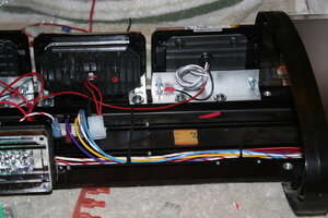

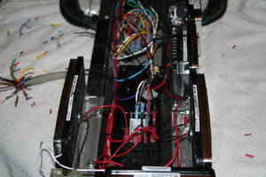

Custom lightbar made from a Code 3 2100 base.
I was looking to somehow add clearance lights and additional work lighting to my truck with some warning capabilities. As it turned out, the more I tinkered and built, the more warning lighting it ended up with. The original had takedowns, angled alleys and rear halogen spot lights.
Original:
It turned out that the takedowns and rear spots weren't effective/used enough for me to keep around and I didn't like the angle on the alley lights so I decided to add additional warning lights. There are no pictures of it but revision 2 was the addition of another Sho Me flasher to unsync the rear amber and red lights (evident in the video).
1st Revision:
Clearance light function (tied into park lights) with cruise lights activated.
Video:
The bar ended up with:
Code 3 base/domes
Federal Signal wire harness
Code 3 LED-X Heads
911ep Stars
Sound Off Predators
Whelen 0S lights/LED Clearance lights
Whelen ULF 44 flashers
Sho Me 11.1005SF LED flashers
